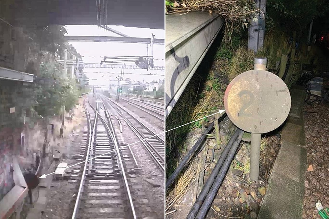

The RAIB report does not state the speed limit on the main (non-diverging) line, but it does say that the train's speed (45mph) was within the limit, so we can conclude that the non-diverging route's limit was at least 45mph.
The RAIB report also states that the speed restriction sign (see photo above in the thread) should have had a left-hand arrow (to indicate that the 25 applied to the diverging route).
Without the arrow, the 25mph would mean that the restriction applied to both routes, would it not? In which case, I'm surprised that the RAIB report makes no mention of this. How many trains passed the sign at 45+mph (drivers' route knowledge of the speed restriction on the main route ) and how many were surprised by the 25 sign. How many did or didn't report the anomaly?

As I understand things, it mostly relies on the driver's training and paying attention to the preceding signal which would have indicated that a turnout was being taken; that's why there is such an emphasis on route-learning, and one of the demands often quoted when drivers' reasonably generous pay is discussed. The speed limit sign itself even if clean and well-positioned is unlikely to be seen from far enough away to form the main instruction, and is not intended to do so. It really just means "This is the exact point where the speed restriction you are already expecting starts", and if the drop in speed is significant there is an advance warning sign. Reading the RAIB Safety Digest https://assets.publishing.service.gov.uk/media/6798ebbf4686aac15860641e/D012025_250127_Manor_Park.pdf I'm not sure the driver would have driven differently if the sign had been more visible.

Elizabeth line train speeding 20mph over limit left passengers shaken
Posted by ChrisB at 16:39, 29th January 2025
From the Independent
Travelling at almost double the speed limit caused the train to ‘jolt sideways’
A speeding Elizabeth line train caused passengers to “lose their footing” after the driver “became confused” about the rerouted train’s location, a report has revealed.
According to the Rail Accident Investigation Branch (RAIB), the train was travelling at 45mph (72km/h), 20mph faster than the maximum speed for the junction, after being diverted because of a track circuit failure on 24 September 2024.
At least one passenger “fell to the floor” on the Heathrow to Shenfield service as the train “jolted sideways” near Manor Park station, CCTV footage shows.
After being “routed off its booked route”, the driver became “confused about the train’s location” and failed to reduce the train’s speed to 25mph, the report found.
A member of staff onboard reported the overspeed to MTR control as the driver “did not believe” that the jolt was “severe enough to report”.
RAIB’s investigation recommends that route risk assessments “identify the opportunities needed for drivers to effectively refresh their route knowledge, particularly where there are alternative routings available”.
The RAIB added that an “incorrectly placed, inconspicuous and dirty” 25mph speed limit sign was partly to blame for the incident.
Network Rail is responsible for maintaining infrastructure, including permissible speed restriction signs, on the Elizabeth line.
There is no in‑cab indication given to Elizabeth line drivers about permissible speeds on their route.
“At the time of the incident, the sign was positioned under the bridge, and partially obscured by lineside equipment, which made it difficult to see. It was also covered in dirt, further reducing its conspicuity and legibility,” said the rail safety investigator.
Network Rail’s “Track Work Instruction” guide on ‘How to maintain signs’ states that signs should be kept clean and in good repair.
Director of the Elizabeth line Howard Smith said: "We apologise to customers who were on board the train during this rare incident."
