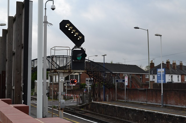

No ARS (Automatic Route Setting) at Wokingham.  Its a mechanical signalbox that works colourlight signals.  No flashing yellows.  Probably won't be any independent investigation.
This is what the driver should have seen before departing the platform at Wokingham.
Stuving, in your photo isn't the line to Bracknell/Waterloo the line to the right not left?
So it looks like a driver error then if the white indicated route lights were not alight which is what it would be for the Guildford line unless there was a dodgy wire somewhere in the electrics which displayed the indicated route lights or as I said in a previous post on this thread, the train was a non-stopper and by the time the driver had sighted the signal with unlit route indicator lights braking distance was such that the train couldn't be stopped before traversing the junction pointwork.
You are right - my imperfect adjustment of viewing direction; sorry.
