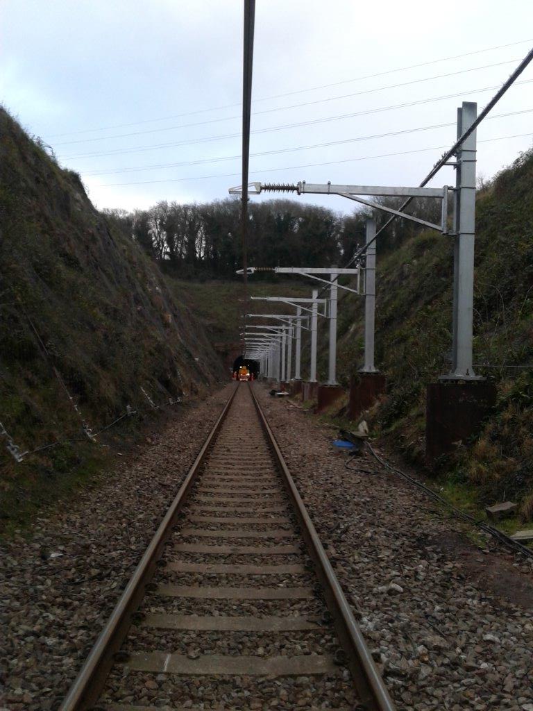

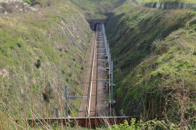

UK (United Kingdom) first: Patchway gap on Great Western (between Patchway Short Tunnel & Patchway Old Tunnel) has just been wired with tensionless conductor bar as part of the electrification programme. Due to the size of gap (160m) it would have been difficult to wire in a tensioned system
Other photographs here: https://mobile.twitter.com/25kv/status/1114928419383463937?lang=en
