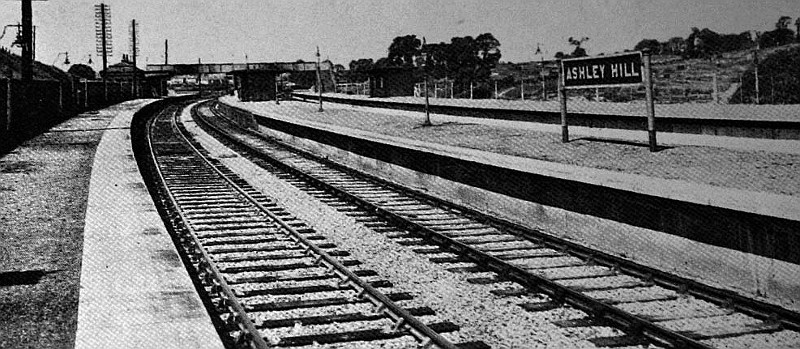

Browsing during the night ... some interesting official GWR (Great Western Railway) pictures from the 1930s from the Bristol Railway Archives http://bristol-rail.co.uk showing Ashley Hill and Horfield stations.
Both shown on some of the FoSBR» (Friends of Suburban Bristol Railways - site) suggestions ... what chance?  Any of the four track work being done in such a way as to protect the site(s) at least for platforms on what will become the slow (or will they be know as relief?) lines?
The Horfield site, shown on the photo, has not been chosen as a potential new station according to what I have read. Consequently, I think a lot of the bank reinforcement work there has made no passive provision for a platform.
The picture itself seems to show the station after it had closed as the access routes and  the wooden ticket office by the bridge have gone.
If you are heading north along the line you can still see recesses in the bridge structure on the left hand side where one or two of the wooden joists for the ticket office were fixed to to the bridge itself (the other support being posts into the bank).
I'll attempt to add a photo showing the station with ticket office in a while.

Horfield Station the aforementioned ticket office and access routes.
http://bristol-rail.co.uk/w/images/5/51/Horfield6.jpg

Horfield didn't have a signalbox, the signals shown were the up relief and up main homes the main line being the pair of lines on the right in the photograph, the box operating those signals was Filton Incline Box the following box being Filton Junction box, a box I spent many hours in with my schoolmate train spotting in summer school holidays as his father was a signalman there.
