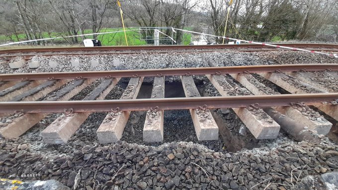

The picture RAIB used looks bad; this one from Phil Barrett on X shows a scarily deep hole, and may be worse:
Why was there a big void under this embankment-cum-"sea"-wall? Note that there is no obvious place for that much stuff to have come out; the seaward side is stone faced and there is a closely observed ditch to the landward. Was a void always there, perhaps due to the difficulty of building a railway across a tidal estuary?
You can see the outlet hoses of some pumps NR» (Network Rail - home page) have been running to try (with limited success) to stop the area behind it flooding; was that in any way a cause? Is nature getting its own back, resenting the Ulverston and Lancaster Railway's interference? The course of the Winster before it was diverted away ran just under here; is that relevant?

RAIB (Rail Accident Investigation Branch) have published their report into this accident. As usual, it has loads of details about arcane topics like the history of land drainage in this part of the world. This is the summary:
At around 06:05 on 22 March 2024, a passenger train travelling at 56 mph (90 km/h) derailed on the approach to Grange-over-Sands station. The derailment occurred because a void had opened in the embankment on which the train was travelling, leading to the rails under the train losing support. The train was carrying four train crew and four passengers when it derailed. Nobody was injured, but significant damage was caused to both the train and the railway infrastructure.
RAIB’s investigation found that the void had been created because water had dislodged embankment material and carried it away. The water came from a pipe partially buried beneath the railway, which had been damaged during routine maintenance around 2 days before the derailment.
The damage to the pipe had been reported immediately to the railway control room by the maintenance staff involved. However, as a result of ineffective communications, no action was taken to stop the consequent leak. The pipe had been installed by Network Rail in 2016 as a temporary measure to assist in managing flood water in the surrounding areas, but on-call engineering staff were unaware that it was in use and carrying water at the time it was damaged.
Underlying factors to the accident were that those responsible for managing flood water at this location had not done so effectively, leading to the prolonged need to rely on temporary pumping arrangements. RAIB also identified that staffing levels at Network Rail’s Carnforth maintenance delivery unit did not provide sufficient resilience and had allowed non-compliance with the standards relating to the management of tamping to become normalised. In addition, Network Rail had allowed a temporary pumping arrangement to become permanent without applying the relevant asset management procedures.
One bit of their explanation that is hard to believe, and well outside the experience or expertise of most of us, is where the sand lost from the void went. Supposedly it went down below ground level and then inland and along the embankment westwards, through "solid" ground, and came up in the pond where water collects before (in theory) flowing away via the drain along the sea wall. That was 80 m3 of sand, in 52 hours, a distance of over 100 m! But the report claims that "the bulk of missing material from the embankment could be found in the pond".

That video has the graphic of water flow by "soil piping", which suggests it came up some way away, i.e. in the pond. But the words in the report just say the sand was "deposited" there. So maybe it came out higher up and went into the drain at the back of the embankment, and was carried along that to the pond. Otherwise, I guess the water table is barely below ground level, so this extra water is flowing through water that's already there. And presumably already flowing, too.
The report discounted the idea that sand and silt, that comprised the majority of the railway embankment, had been washed into karstic voids in the underlying limestone basement. This was identified as the reason for a collapse near to Grange's signalbox in 2019. The soil piping occurred within the embankment material and underlying salt marsh sediments and didn't enter the underlying original marine sediments. Reports of the embankment 'exploding' in the area of the train's final resting place suggest that there was a significant hydraulic head within the embankment itself sealed by the outer seawall skin. The amount of material moved by this quantity of water in the time available is quite believable and my thoughts are that the soil piping was already present prior to this breach. The tamping damage was just the final straw.
