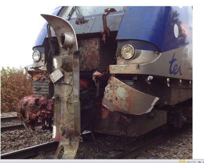

Here is that picture of the front of the train, put on Twitter by Sud-Rail (a union for those who find the CGT too meek).
I have read that BEA-TT will investigate, though any initial report is still more likely to come from SNCF (Societe Nationale des Chemins de fer Francais - French National Railways).

This is the sequence of events, from the BEA-TT report:
Before even striking the deflector (well-called cow-catcher in this case), impact with the animals bent the Scharfenberg coupler arm and ripped off the electric connector and the brake pipes.
Not only was the air in both pipes lost, but the main DC (Direct Current) power line (72V) shorted to chassis. That tripped all the breakers on the supplies (float battery), leaving almost nothing still powered.
The two carcasses were trapped under the front of the train for a short while, then pushed under and the train passed over at least one. On all four bogies, the purge valve assembly (which is mounted lower then the bottom edge of the deflector!) was struck, its cover bashed in, and all the brake air vented.
Thus the brakes which the driver had applied (at emergency) a second before impact all released, and stayed off. There were electromagnetic track brakes for emergency, but those ran off the 72 V DC...
Loss of power took out all the train's control system other than the most direct (air brakes) and, for example, the driver's train radio, intercom, and PA (Public Address (broadcast loudspeaker announcements) or Passenger Assist (railway staff providing physical assistance to passengers with mobility issues), depending on context).
The real piece de resistance of this, however, is that there was an accident in 2009 (Sallanches) with enough similarities to forewarn that this could happen. There it was a car, lumps of which went under a train with ten bogies. On all bogies the brakes were damaged and lost effect, to varying degrees, but with some still braking and the electromagnetic brakes too (no loss of 72V) the train stopped OK. Some changes to the protection of the brakes was ordered, but I can't see a clear statement that these had or had not been made on this train.
Doesn't it make you think, though, that putting all those vital train-wide systems into a coupler, and putting that sticking out of the front of the train, is just asking for trouble!
